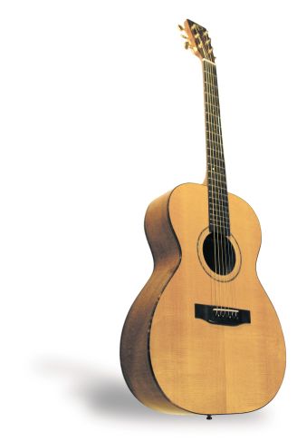

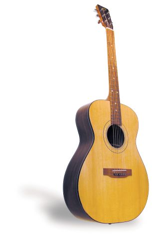

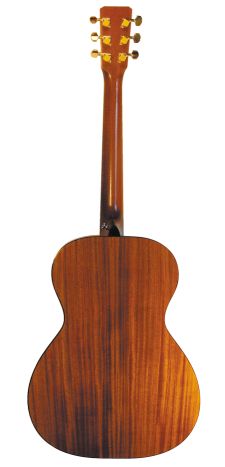

Okay, here comes the bandwidth hog again...the photos of my latest 3 are back...
PostPosted: Sun Nov 13, 2005 8:44 am
Very Nice Larry.
I like your little birds !

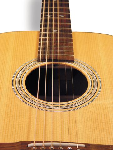

I'm intrigued by the pin positions on the bridge shot, what the theory behind setting the little e back ?

Great job Larry, I really like your rosette!

Believe it or not, that was to cover a mistake in the original layout of the rosette!    I've since started using only Green Select Ab in the inner ring and with the Greven rosette cutter, I set it up the one time, and now don't have the problem of laying one out wrong!    Thanks for the compliments! Now let's see one from you!
PostPosted: Sun Nov 13, 2005 1:27 pm
Walter,

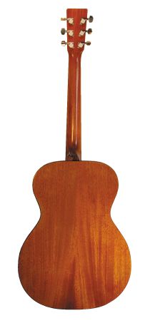

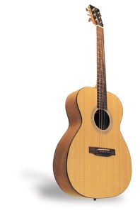

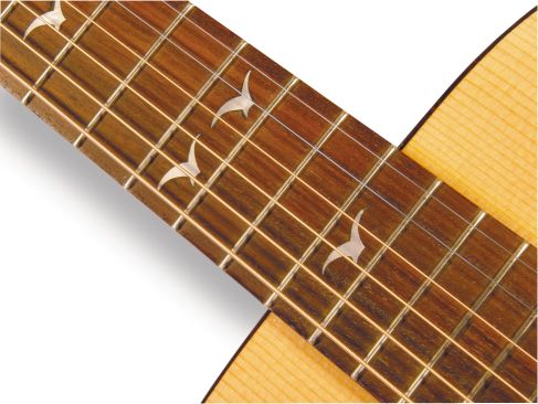

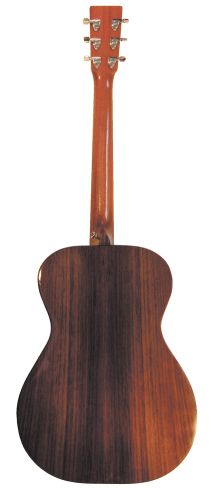

The binding came from Stew-Mac...I don't believe LMI was carrying the binding at the time...(if they even are now )...the first guitar is a sitka/mahog Grand Concert shape, RW f/b, MOP "dove" inlays..(Ok, so they're the dove shapes from my Headstock logo!)...sounds like you'd expect from a small bodied sitka/mahog....pretty good, but won't knock you backwards...the second is a sitka/sapele Grand Concert shape, Ebony f/b, and the interesting headstock is a result of DROPPING the neck in the laquer stage, right on the corner of the headstock...oh, what to do!??...So, grind of the corners and hope it looks okay to it's future owner!    It did!!      The 3rd guitar is a sitka/EIR OM for a promising contemporary christian artist...RW f/b, plain "dot" inlays...but was the first time I used side purfling...I really like the look of it, and will try to side purfle (is that a word?) more in the next batch...thanks for looking! I just love the edification/comments/critique/wisdom on the forum!

Just a trick of the light! The little E is right in line with it's brothers!
